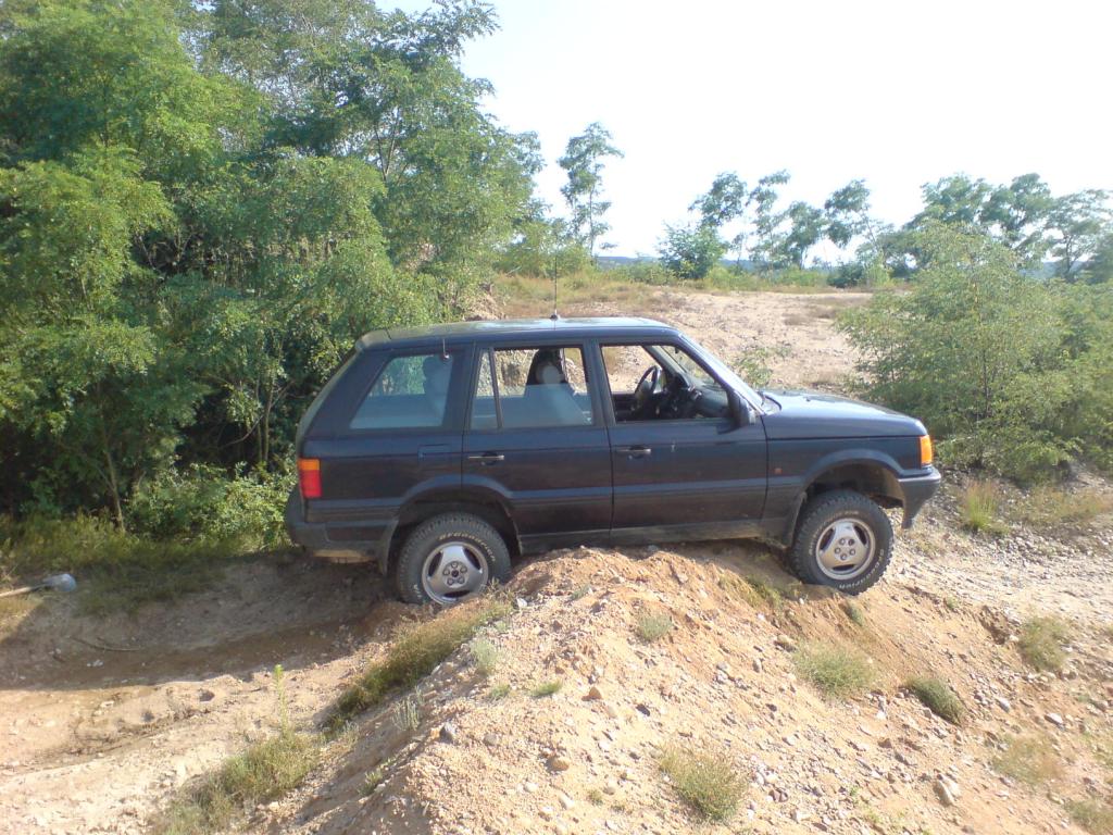

TAK DNESKA SEM SE ZASE VYZNAMENAL A MANŽELKA MĚLA KECŮ JEŠTĚ ŽE VOZÍM POLNÍ LOPATKU A MUSÍM SEBOU VZÍT DO SOSNOVÝ DCERU ASI DOZOR
SEM SE ZAPOTIL NEŽ SEM TO VYHRÁB
