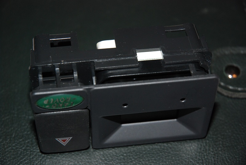

Hodiny se mi jeste vyndat nepovedlo, ale pri hledani toho, jak vypadaj vyndany, jsem objevil nasledujici zajimavej odkaz
http://www.twenga.co.uk/dir-Jewellery,W ... -part-6716
Tak uz se mi to za pomoci rady z netu a dvou starejch kreditek povedlo vyndat
Bez nejakyho rozdelavani veci okolo. Pridavam jeste fotky vyndanych hodin, kde je videt, kde jsou ty zobacky, co to drzi.
To move the clock forward use at leat three cards - 1 on the right of the clock 1 on the left of the door locking switch and 1 at the top or bottom.Make sure you hear the click of the plastic releasing the clock and as you are doing this push the clcok from the rear of it.
(After a good few minute's I realised the clock and door locking switch come out together.)
I knew those point collecting card's would come in handy for something !
When it is out turn it upside down and you will see the rear of a small plastic twist type bulb. Turn it a little with a flat screw driver and it will drop out.
